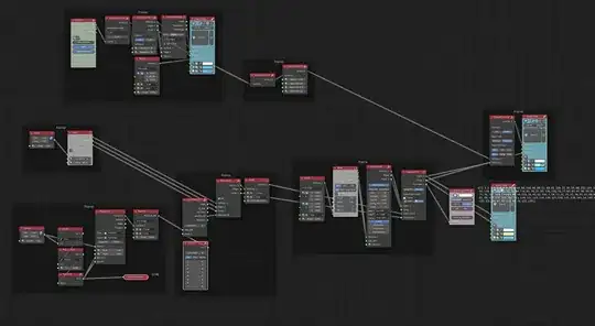

  • Nodes for your task are:
    adaptive edge, adaptive polygon, tesselate and trim surface, evaluate surface Also look at examples. You can find examples here: https://github.com/nortikin/sverchok/wiki/interface-overview
    – nikitron May 06 '21 at 11:47
example
try to keep your nodes in order
investigate:
nikitron
  • 1,022
  • Wow - this is superb. I have to admit, there's much that I don't understand here - well, most of it, but plenty of food for thought... I may be some time... Thanks – Strawberry May 06 '21 at 22:41
  • there are many ways to make wrapping, with approximate or exact dimentions and with mesh or curves or surfaces. it can be projection on surface also. – nikitron May 07 '21 at 15:28
