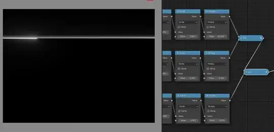

To create the falloff function, I will use three exponential functions: one for the short, initial flash of the electron beam, one for the slightly longer colorful trail, and one for the faint ghosting.
This is the first function.
The important values are the divisor of the second node and the factor of the last node. They are the length of the trail and the brightness respectively.
To create the other two functions, just select everything after the subtract node, press ⇧ Shift⎈ CtrlD and move 'em down twice.
Adding these all together with the values I used gives this.
