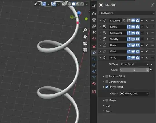

As usual we'll begin with a simple vertex. Easiest way is to add a cube, or plane, and go into edit mode, vertex select mode, select all with A then Right Click > Merge > At Center.
Add a Displace modifier set to X, lower the midlevel and increase the strength. Don't mind the vertex group, you don't need it.
Add a Screw modifier, increase the screw, iterations and steps (viewport and render)
Let's give it some thickness ! First add another screw, but set the steps to 1.
How to create a noodle. Don't worry about the wonky shading just yet.
Add a Bevel modifier set to angle and crank up the width. Add a Weld to remove the seam in the middle.
The tricky part. Add an empty, set it as the object offset in a new array modifier. Now we drive the empty rotation so that the result is always equally separated.
Set the array count to 10.
Add a Bezier curve, scale it. Add a Curve modifier to the other object, and set the curve as the target.

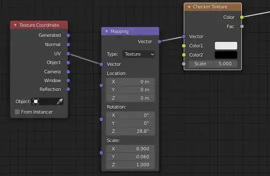

In my opinion there is no need to create the actual geometry, since you may achieve the same effect (more or less) with normals and displacement (if you are using cycles microdisplacement will do the trick).
So I would start with a typical cylinder and I would use a seamless texture with stripes.
The trick is simply to rotate the texture, for few degrees enter image description here
Just keep always in mind that there must be always a proper ratio between the rotation (degrees) and the thickness or the count of the stripes.

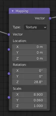

    How have you got the rotation there? Have you manipulated the UV map to rotate the faces? Also, please explain why the Checker Texture.... surely that will produce edges when it gets to the next row (or, presumably, the Scale settings are avoiding that, to a certain point. How do you calculate the angle to use to make it seamless or is it just 'by sight'? – Rich Sedman Feb 17 '21 at 12:19
    For the rotation/manipulation I am using the mapping node (there is no need to alter/edit the UVs of the object). Mapping node provides all the basic transformation you need to change a texture, which in this case is a checker. So what I did was to shrink as much as it was needed the Y scale and raise the X. I could probably use a gradient with a ramp if I was looking for smooth "edges" in my texture. Regarding the angle it is adjusted intuitively. Try to replicate it and play a bit so you can understand how it behaves. – cnisidis Feb 17 '21 at 12:31
  • Oh, I see - because the Rotation applies before the Scale it's already rotated in relation to the 'straight' UV mapping and that's where the twist comes from. Nice solution (just need to be careful it doesn't get to far along the texture. – Rich Sedman Feb 17 '21 at 12:59
  • cnisidis and @RichSedman I've been trying to automate this, and can't get the numbers to make any sense.You want to rotate or shear the rectangular UV space so the phase at Y=1 is the same as the phase at Y=0, and the rectangle can be rolled into a tube with the edges matching. Tried with a shear, too, but parameter that works is always slightly off the one I would expect.. it would be nice not to have to eyeball it. – Robin Betts Feb 18 '21 at 08:07

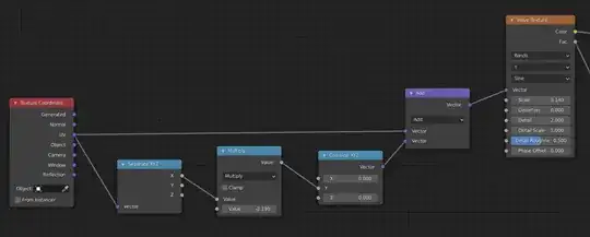

To get the twirly effect, we will have to play a bit with the coordinates. Thankfully it is not too hard since the UVs are nicely mapped to to body of the curve. We will use the Y coordinate to offset the wave, creating the twirl.
First change the wave texture to be along the Y axis. We will offset the Y coordinate by a multiple of the X coordinate. You can play with it. I recommend starting at a low multiple and working your way up, else you won't see much happening.
The nodes :
Result :

  • Thank you. If I may say, the black part should be one stripe instead of many rings. Is that possible? – jjk Feb 17 '21 at 15:51
    @412p9wej I see, I edited the answer, is that what you are looking for ? – Gorgious Feb 17 '21 at 16:36
    Mesmerizingly good. – batFINGER Feb 17 '21 at 16:47
  • @Gorgious Outstanding :) I'll pour liquid and put licorice into that tunnel. I will need geometry in order to have correct interplay between all objects don't I? If so, I will gladly edit my question and emphasize on geometry – jjk Feb 17 '21 at 17:06
