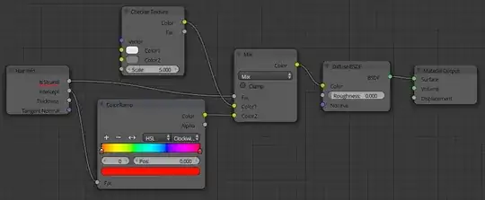

    Aye, this does the trick, thanks! The setup I used based on this was a little simpler, though. I put the color values directly into the ColorRamp node and then passed its output to the color of a single diffuse shader. I had thought that would be more efficient, but doing a quick test found no difference in rendering speed or memory usage. – Zauberin Stardreamer Nov 17 '14 at 18:47
To add to what was said in this answer, you can use Is Strand to make the hair and the base material different using only one material.
The Is Strand output of the Hair Info node gives a black and white mask. White on what is hair, and black everywhere else (the plane in my example.)
Take this colorful spiky image. I have only one material on the plane. That material is controlling both the checkers and the hair's color. colorful spikes on a checkered plane
Here are the simplified nodes for the material I used in the image above.
cycles materiel nodes
I'm simply using the Is Strand as the mix factor to determine where each part of the material goes, on the hair or on the plane.

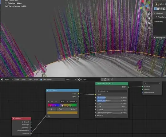

I am not sure about previous versions. But from 2.8 at least forward you can get a very simple set up with the Hair info node and a color ramp. Set the hair info to "intercept".
using intercept
additional colors
Also you can get a random seed color look by using the "Random" setting.
random

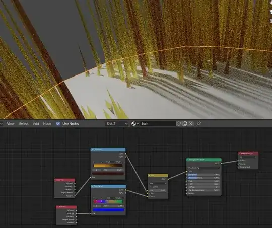

Continuing with this concept, you can now also combine these effects with your desired blend mode and amount with a Mix RGB node.
random brown
random brown and strand color
