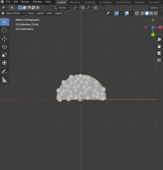

Firstly, I am new to Blender. I am actually working on to create a hemispherical model with cell fractured property.
1. I have done this work manually using cell Fracture add-on and now I want to automate using python.
2. I have written the code till particle implementation on the hemisphere. Now I want to create a cell fracture with those 100 particles.
I have attached the hemisphere picture and the final output needed. I have also attached the code. Please provide me an insight on how to do this using python.
Code till Particles in Hemisphere:

Image: Hemisphere with particle feature
Hemisphere with Particles

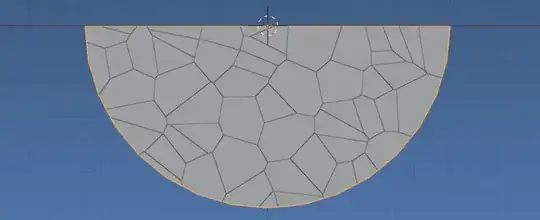

Image: Final output required with cell fracture
Hemisphere with cell Fracture

Add particle system as suggested here Python and particle system
Make sure the cell fracture addon is enabled, and call the operator
bpy.ops.object.add_cell_fracture_objects()
Which uses defaults as mapped out in doc string
>>> bpy.ops.object.add_fracture_cell_objects(
bpy.ops.object.add_fracture_cell_objects(source={'PARTICLE_OWN'},
        source_limit=100,
        source_noise=0,
        cell_scale=(1, 1, 1),
        recursion=0,
        recursion_source_limit=8,
        recursion_clamp=250,
        recursion_chance=0.25,
        recursion_chance_select='SIZE_MIN',
        use_smooth_faces=False,
        use_sharp_edges=True,
        use_sharp_edges_apply=True,
        use_data_match=True,
        use_island_split=True,
        margin=0.001,
        material_index=0,
        use_interior_vgroup=False,
        mass_mode='VOLUME',
        mass=1,
        use_recenter=True,
        use_remove_original=True,
        collection_name="",
        use_debug_points=False,
        use_debug_redraw=True,
        use_debug_bool=False)
(undocumented operator)
Test code, produces result as in image above.
import bpy
from addon_utils import enable
make sure cell fracture is enabled
enable("object_fracture_cell")
context = bpy.context
Draw hemisphere of 1 m radius
bpy.ops.mesh.primitive_circle_add( radius=1, enter_editmode=True, align='WORLD', location=(0, 0, 0), fill_type='NGON', # NOTHING or NGON )
bpy.ops.mesh.bisect( plane_co=(0, 0, 0), plane_no=(0, -1, 0), clear_inner=True, )
bpy.ops.object.editmode_toggle()
Particles
ob = context.object ps = ob.modifiers.new("Part", 'PARTICLE_SYSTEM').particle_system ps.seed = 1 ps.settings.count = 100 ps.settings.frame_end = 1
cell fracture
bpy.ops.object.add_fracture_cell_objects()

    Thank you so much..!! This gives me the clarity of coding in Blender and also the solution to my problem. – rasunag27 Aug 04 '20 at 04:57
  • I was trying the code provided by the chosen answer on Blender 2.92 which was failing, the needed change is to use add_fracture_cell_objects instead of add_cell_fracture_objects. – Anas Einea Mar 22 '21 at 15:26
  • Thanks for the heads up. The cell fracture in the version of 2.92.0 RC I am using is still working as above. What version of 2.92 did you notice change in?. – batFINGER Mar 22 '21 at 19:16
