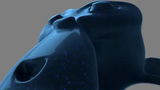

This is something that has been irking me for a while, as I've been working on a car project. I'm trying to create a paint (in cycles) similar to the the material in this image:
The problem is, whenever I try to make it, it always comes out looking to diffused or too sharp.

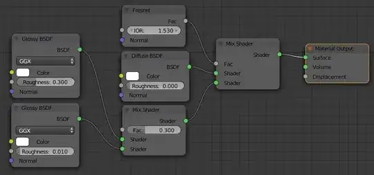

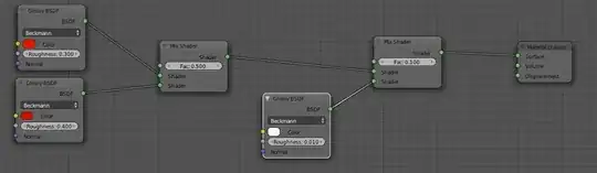

Here's my node setup:

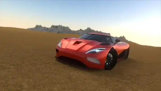

And here's the render:
David

    Instead of mixing a bunch of glossy shaders, try mixing with a matte shader (diffuse or velvet). You can also play with using a fresnel as the mix factor. You'll probably just have to play around with the shader for a while to get something that looks nice. – Azmisov Oct 18 '14 at 20:28

I'm not completely sure what you are going after, but for an image like the top one lighting will be very important.
I don't have car model to demonstrate, but hopefully this gives you some ideas:
Material nodes:
If you want that paint fleck look that a lot of car paints have, try using a voronoi texture to modify the normals of a glossy shader underneath the main surface:

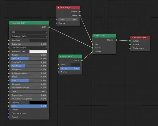

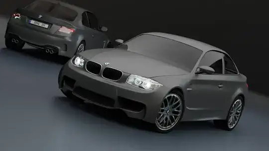

A matte car paint can be created with only five nodes:
  • Principled BSDF
  • Velvet BSDF or another Principled BSDF
  • Layer Weight
  • Mix Shader
  • Material Output

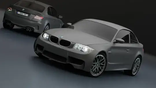

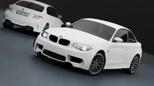

Material using Velvet BSDF for sheen
Matte car paint black using Velvet BSDF Matte car paint white using Velvet BSDF The BMW demo scene was create by Mike Pan
Shader
The Principled BSDF should have a Roughness between 0.3 and 0.5 depending on how matte the paint should be. I left all other parameters at their default, but the Specular value could be adjusted as well.
The Velvet BSDF in combination with the Layer Weight and Mix Shader nodes are the key to create the typical sheen of the matte car paint. The Facing output of the Layer Weight is used to blend between the Principled BSDF and Velvet BSDF.

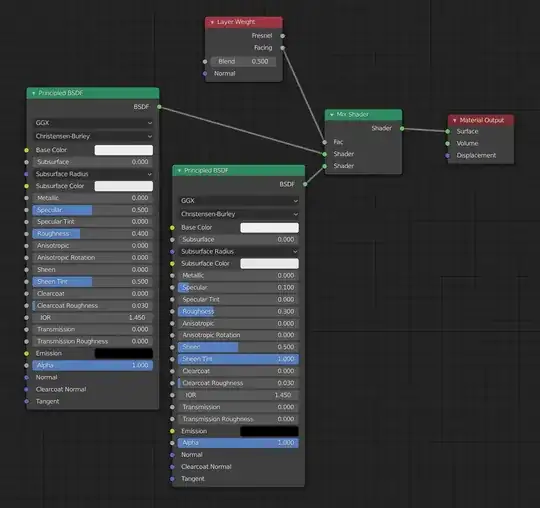

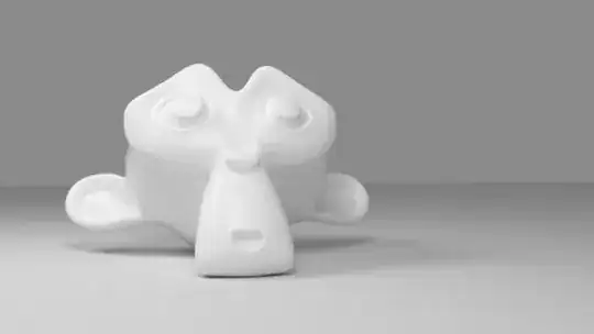

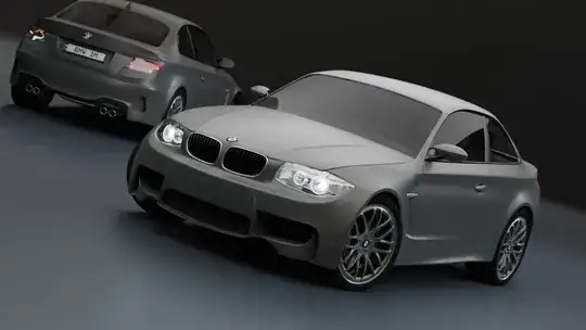

Material using Principled BSDF for sheen
Matte car paint black using Principled BSDF
Matte car paint black using Principled BSDF The BMW demo scene was create by Mike Pan
Shader
In this variation the Velvet BSDF has been replaced by a Principled BSDF. The Specular parameter can be adjusted to control the amount of specular reflection in the areas with the sheen effect.
Specular set to zero Specular set to zero for Principled BSDF with sheen
