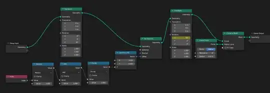

Geometry Nodes

Another way to move control points up and down from object centre to easier change a shape and animate ...

Sorry ... Do you see it asymmetrical now in this setup? Or I didn't get the point :) – vklidu Feb 04 '23 at 13:06
I meant it looks like the left part flatten first or as if the left part is initiating the transition (not only your solution but 'all'). I was wondering if it is possible to do it so that both sides (left/right) are symmetrical? – lemon Feb 04 '23 at 13:10
Hm ... I have a problem to imagine how such thing moves (other than the stacker's answer. – vklidu Feb 04 '23 at 13:17
