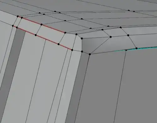

Its mesh once had bezels, but I've decided to scrap them for now in order to lower the complexity of my mesh. In turn, this has caused the mesh to become a bit messy:
The messy mesh.
My goal is to make the top of the vehicle an even surface while still retaining its angle, and my loop cuts as straight as can be. I've highlighted my objectives in red.
The uneven surface.
The crooked loop cut.

  • https://blender.stackexchange.com/questions/64592/how-do-i-space-quads-evenly/64595#64595 https://blender.stackexchange.com/questions/43903/is-there-a-way-to-align-multiple-vertices-to-another-vertex https://blender.stackexchange.com/questions/33525/straighten-vertices-along-a-line/38800#38800 – Duarte Farrajota Ramos Apr 26 '20 at 03:02
  • If you want an edge loop to align with the next edge loop, press GG to slide, then E ,or E then F to align with the opposite side. – moonboots Apr 26 '20 at 07:19
