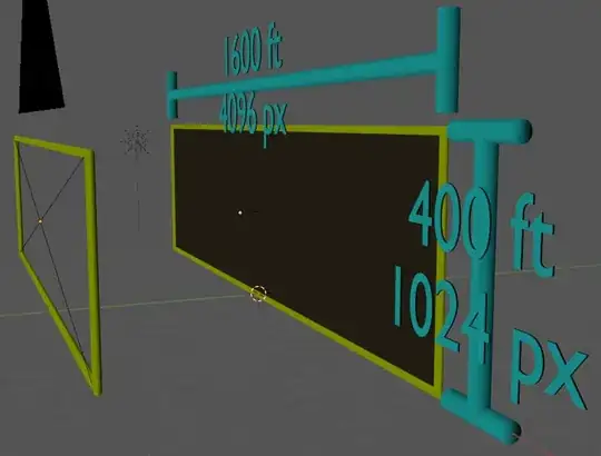

In my case, I have a flat, vertical plane that's 1600 feet wide by 400 feet tall. It will (hopefully) end up being a cliff face I plan to import into another scene as a bump-mapped diffuse texture. So I set up an orthographic camera that will render to a 4096 x 1024 image for the final material.
Scene setup with illustrated dimensions.
Render dimensions of 4096 by 1024.
Camera setup with inaccurate values. Unit setup showing Imperial system, scale is 1, length is feet.
Since the plane is 1600 x 400, with the base centered on the world origin, that puts its center at [0 ft, 0 ft, 200 ft]. I simply put the camera at [0, 0, 200], then moved it along the -Y axis. Since cameras point down by default, I rotated it 90° on the X axis, then it was lined up. Again, for more complex angles you might need a bit more math.

As explained in Duarte's answer, the scale of the camera is such that the largest dimension of the output render will be mapped to scale units in the scene. In this case, the output is wider than it is tall, so our scale tells us the width, in Blender units, of the camera.
I initially tried using 4096, then noted that 409.6 was somewhat close. But it's not really close. AAARRGGG!!!! Why??!?!? Blender, whyyyyyy!?????????????
Ortho view from camera showing the camera doesn't fill the desired area (too small).
