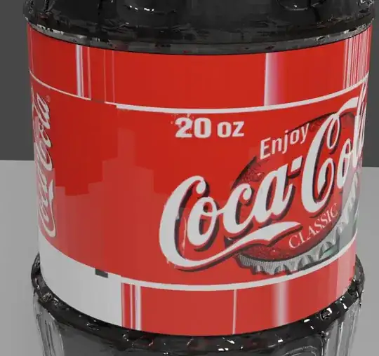

The way I add condensation effect is to add a texture image (condensation) to object material. However, I don't think we can use this method to add the effect on a texture? As it would be like adding texture on to another texture.
For example the label(coke) in picture below are a texture, how do we add condensation on it?
Thanks in advanced.
vuict
    Hello and welcome :). The easiest way is to use a normal map and connect it into the normal input. That way you don't have to mix/combine anything. – jachym michal Mar 13 '20 at 06:47
    @JachymMichal Thanks. just tried it, the condensation did appear on the label! However, it has problem on the scaling. The water droplets appeared horizontal stretched, and when I tried to correct it by scaling on the UV map, the Coke label was affected as well (became too thin or too wide). Maybe there is a way to scale individual image rather than to scale the UV unwrap area? – vuict Mar 13 '20 at 08:41
    Hello :). Don't scale the UV map directly, but use the Mapping node for each image. This thread should help. Also, it's sometimes useful to use a second UV map for the condensation, for better control. – jachym michal Mar 13 '20 at 08:46
  • @JachymMichal hey, that actually worked :) – vuict Mar 13 '20 at 09:48
    And now I am looking for where the Accept Answer button is..... maybe I am new that I dont' have that option? – vuict Mar 13 '20 at 09:54
    There's no way to accept a comment :). I'll post a full answer later, so you can mark this question as solved. – jachym michal Mar 13 '20 at 10:00
You can use a Normal map for the condensation.
That way you don't need to mix anything, just plug it into normal input.
Example of a normal map.
You can download this one for free from Poliigon.
Connect the normal map like this.
Use different Mapping nodes and perhaps UV maps for better control.
