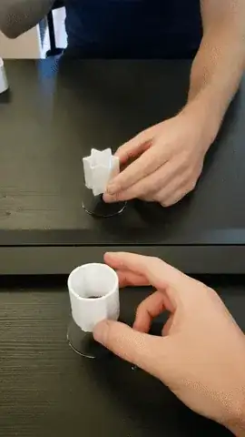

I have worked a lot with making impossible objects and 3D print them. The "trick" in your picture, is that it is something in 2D, but our brains try to interpret it as 3D. So to make this object in 3D, you would have to go the other way: "project" it back to 3D. This will only make it look this way from certain angles/distances, though.
Here are some examples I have made. They are based on ambiguous cylinders math by Kokichi Sugihara. Check out his papers for how to do this.
File on thingiverse - or try rotating it here
As you can see, it's really a curved shape, but from certain angles it looks like a star/flower, or from another angle it's a circle.
