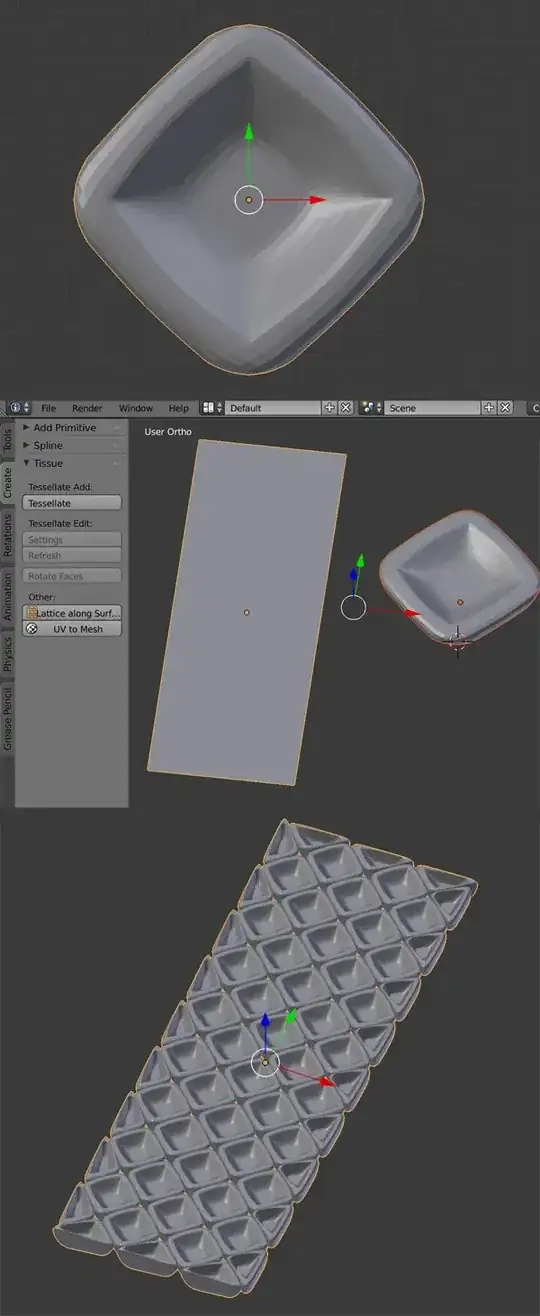

You could repeat a pattern with Array and Curve modifiers, but as Serge L says, a quick way would be to use the Tissue addon. The next Tissue addon made by Alessandro Zomparelli seems amazing by the way (Blendconf presentation here):
Create a plane, subdivide it, press CtrlE > Un-Subdivide, choose an Iteration value of 1 so that it creates lozenges instead of squares.
Create your module, make it rotate 45° on the Z axis. In Object mode select the module, then shift select the plane. In 2.79, in the Tools panel > Create tab > Tissue, press Tessellate, press OK to validate.
