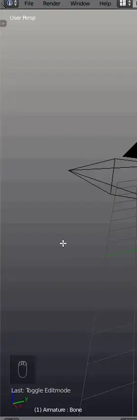

Enter edit mode then hit T to open the tools panel. under options, you will find a check box that says X-Axis Mirror. Check it.
This option will mirror actions performed on bones across the X axis. In order to set up a rig, simply give the bones a left or right side suffix (e.g. .R/.L, _R/_L or _right/_left…) and make sure the rest of the names match. Bones that are centered do not need a suffix, since they are not being mirrored.
Gif
