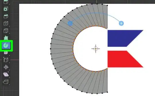

Really dependent of what you want to do once the base shape is done. Above two possibilities, but both may be wrong if the afterpart (if there is) needs a different geometry.
You can 'screw' + 'boolean', starting from a single edge:
Also you can 'spin' twice + 'bridge edge loops':
Spin is more manually done: make a spin for the inner part with x steps (starting from a single vertex). Make a second spin for the outer with also x steps (starting from another single vertex). Select all and in the menu in edit mode 'Edge>Bridge edge loops'.
The resulting geometry is different as the second, more manual approach, keeps quads. Depends on what you want to do after that.

It really depends on what you want to achieve at the end, but you can begin this way:
  • Put your logo as a Background. Create a circle as large as the logo's C.
  • Press E to extrude, presse Enter, press S to scale down.
  • Activate the knife tool with K. To cut orthogonally, press C.
  • Select the vertices on the right and delete. You've got a C shape. But again, you'll probably need to rework on it depending on what you want to do.

Another attempt to revive the golden age of (home) computing: Create a cylinder. In edit mode remove the top and bottom face. On object mode add a solidify modifier and adjust thickness and offset as wanted. Finally apply the modifier. Add a cube which size is bigger than the diameter of the cylinder and higher than the height of the cylinder. Put the cube on the right side of the cylinder. Add a bolean modifier to the cylinder and use the cube as object. Set mode to "Difference". Move the cube towards the cylinder to match the logo. Finally apply the boolean modifier. For the rest of the logo: Model one half of the "=" from a cube and mirror the result with/at/from/by (sorry, no native speaker) x-axis.
