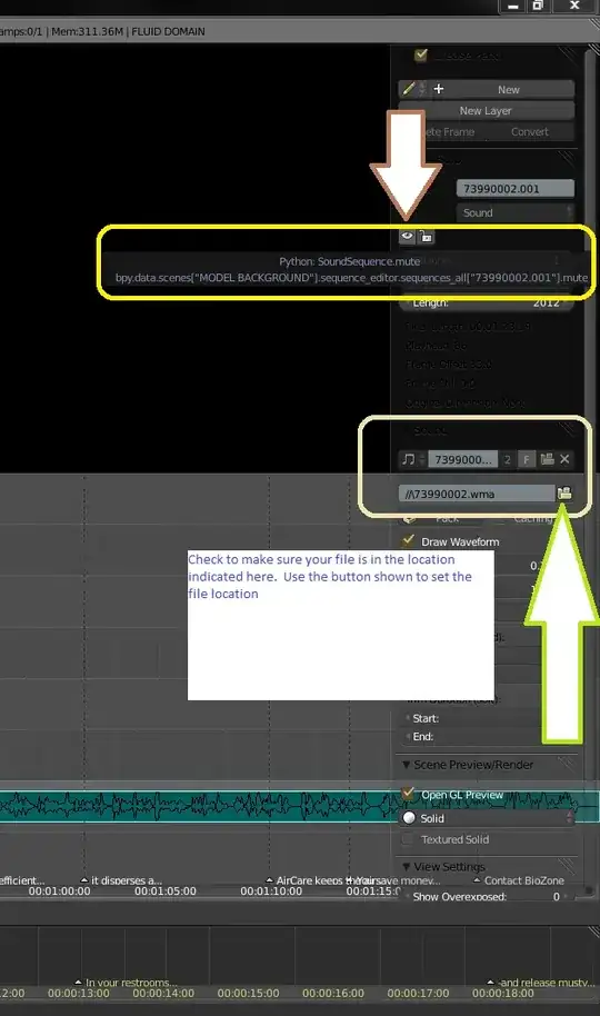

I can think of a couple possibilities:
  • Your audio track is muted in the VSE
    Select the track
    hit n
    deselect the 'eye' button
    VSE track settings
  • Your sequence is no longer pointing to the audio file because you've moved it or the blend
    repath the file using the 'file location' tool button shown in the above image
  • Your scene volume is set to 0
    goto the Scene tab in the Properties frame
    expand the Audio panel
    adjust the volume or other settings

    First of all thank you for taking the time to answer. Audio is not muted, at least not with the eye icon, I have tried to set/remove a couple of times with no use. File path is ok, since audio playback fails even with a new project and opening a new audio file, so that shouldn't be the case. Volume doesn't seem to be the problem either, since I have tried raising it to the top and no sound is played either (The sound file plays correctly from outside Blender so audio source file is OK). – YoMismo Jul 30 '14 at 15:50
  • One thing I have to check as soon as I get home is the last image, I didn't know there was a volume in the scene section, I have raised the volume in the VSE strips, but I didn't know about the one in this section. As soon as I test this I'll post the result. Thanks again for your time. – YoMismo Jul 30 '14 at 15:51
  • No luck. I've checked the volume in the scene section and it was already at 1 which is the highest value, but no sound is playing :-( – YoMismo Jul 30 '14 at 18:58
