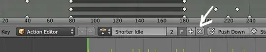

You have 2 armatures, Track Controller (with only one bone, on the left of the machine), and Armature, which is all the machine bones.
Your Dopesheet is in Action Editor mode, it will only display the keyframes relative to the selected armature.
When we open the file, Track Controller is selected, and as it has no action, no keyframes are displayed.
On the contrary, we can see that Armature is animated. It's normal because an action has been assigned to it, and if we select this armature, all the keyframes of this action will be displayed on the Dopesheet.
If you want to close the action playing for a selected object, press the X button on the right of the action name. It won't be played anymore by the armature but it will still be selectable in the dropdown menu if you want it back.
When you close your file, every action will be saved as long as it has at least one user (one object or armature using it) or if you've assigned it a fake user (press the F button on the right of the action name if you want to give an action a fake user). Fake user is a way to make sure that the action you've created will be saved even if it doesn't have any user yet.
About le leap to the side: your bones come back to their rest pose as soon as you come back to Edit mode. If you select all these bones in Pose mode and press altG they will combe back to the same pose.

  • The 2 animations are separate, it's just that whatever object you select, Armature will play its animation, because for the moment an animation is affected to this armature, if you don't want it to play, close it with the X button (in the Dopesheet / Action Editor mode, on the right of the animation name), you'll be able to reload it with the dropdown menu, or make it play later: click on the Push Down button and move the strip in the NLA. Please tell me if you understand. – moonboots Jul 03 '19 at 07:27
  • Sorry, I'm still doing something wrong. So I select the Armature and the "shorter idle" animation. I hit the X to close it on the Action Editor against the "browse action to be linked" name. Then I select the Armature.001 which has the "walking" animation. When I play that, or move the timer, the "shorter idle" animation still plays. If I click to add a new animation, then move the timer on to change the animation in pose mode, the "shorter idle" animation still plays. This means I can't add a new separate animation. – Altissimus Jul 03 '19 at 08:28
  • In the version you shared, Armature 001 didn't play any animation because you didn't select any in the dropdown menu, if you select Armature 001 and, in the dropdown menu, select the action called Walking, Armature 001 will play Walking. If you select Armature and close Shorter Idle with the X button, it won't play Shorter Idle, unless you've clicked on the Push Down button, which means you've created a NLA strip, so maybe you created this strip by accident, open the NLA and check this out... – moonboots Jul 03 '19 at 08:36

  • Again, there are keyframes playing in the action editor: select the armature called Armature, you'll see the keyframes of the selected action for this object. If you don't want any action to be played for this armature, select it, go in the Dopesheet in Action Editor mode, and on the right of the action name (Shorter Idle) click on the X button (Unlink this action). – moonboots Jul 04 '19 at 05:44
  • I've edited my answer, maybe it's clearer? – moonboots Jul 04 '19 at 05:55
  • It's clearer, thank you. However, I explained I did all you said about 4 comments back - hitting the X and all that stuff. It's still not working for me. Anything I do is still resulting in that animation playing. So, nevermind. I've given up and scrapped the model. Going to re-work the whole thing from scratch. Just a shame that someone can't clearly explain the interrelation between armature/animation/nla/whatever when things go wrong. – Altissimus Jul 04 '19 at 09:08
  • if you hit X all the keyframes should disappear, is it not what's happening for you? About the interrlation between armature/animation/nla/whatever, it would be too long to do in this forum, all I can say is that the animation you'll see in the 3D scene will be the one selected in the Dopesheet, or, if there is not, the one in the NLA. – moonboots Jul 04 '19 at 09:10
