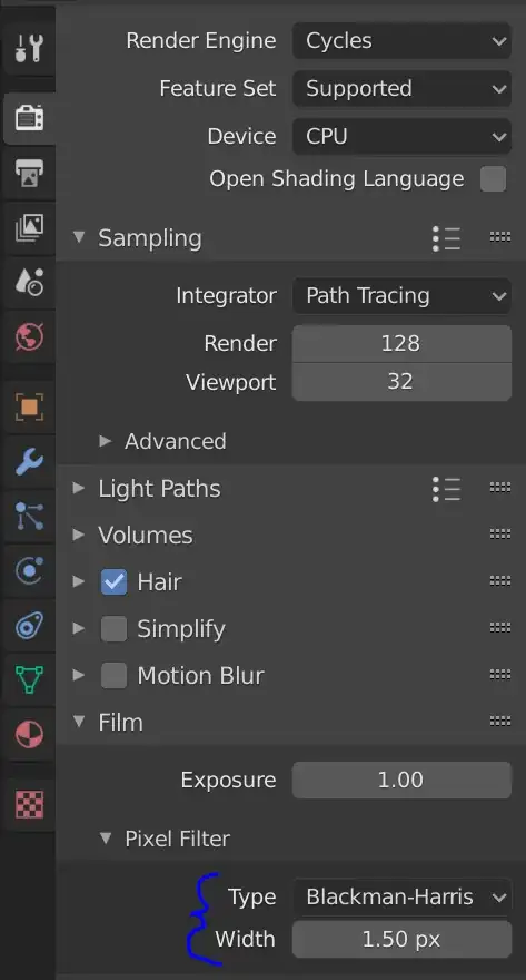

Two things I would add to what's been shared so far:
1. You will also see a difference in edge quality based upon Cycles Render Properties>Film>Pixel Filter settings. Filter "Type" and pixel "Width" will give you wildly different edges, ranging from super crunchy to sharp and smooth to blurry. Automatically, you should get mattes that match your renders.

  • Do you mind adding a meaningful comparison of the defaults vs. blackman-harris? Thanks – brockmann Apr 07 '20 at 06:36
  • Blackman-Harris @ 1.50 px is default for Cycles as of 2.82a with a nice balance of sharpness and anti-aliasing. Box is sharper with no adjustable pixel settings. Gaussian is generally soft with adjustable pixel width. The nice thing about Cryptomattes is that they will automatically match the sharpness of your edges based upon pixel filter settings. – Coby Randal Apr 07 '20 at 07:37
  • Thanks Coby. I need to test that. However, I think Cryptomatte should work out of the box so any side by side image comparison might be nice to get your idea. – brockmann Apr 07 '20 at 08:12
