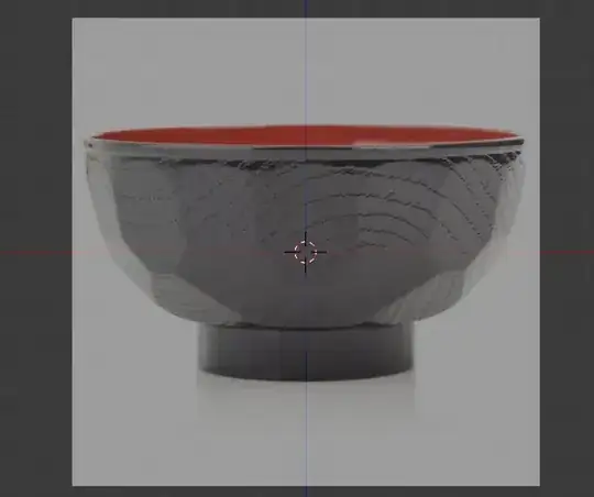

So I'm pretty new to Blender and I want to create a model of this Japanese bowls that aren't uniformly round, instead they have these larger polygons on the outside, as you can see in the picture.
I tried a few modifiers, but I couldn't find anything that would help. Does anyone have an idea how I could get this shape? Thanks.

You could try it this way:
  • Put your picture as a Background image.
  • Create a plane, rotate it on the X axis to have it in front view, apply the rotation.
  • In Front Ortho view, use the picture as a model to build your mesh, mirror the mesh to make it easier.
  • Switch to Right Ortho view and continue to model the mesh. You'll have to shift the mesh from its origin.
  • Come back to Object mode. Create an empty at the same point as the object origin.
  • Give your object an Array modifier, give it a Count of 8, deactivate Relative Offset, activate Object Offset, choose the empty as object.
  • Rotate the empty 45° on the Z axis.
  • In Edit mode, give some corrections to make the vertices stick approximately with their arrayed copies.
  • Duplicate the empty + object to keep a copy somewhere on another layer.
  • Apply the modifiers.
  • Go in Edit mode, remove doubles.
  • Dissolve the useless vertical edges.
  • Make some corrections.
  • Now you have your basic bowl. Of course you'll probably want it to be a bit more sophisticated, like adding some bevels, etc... in that case you can keep just 1/8 of the bowl and again spin it around the empy with an array, add your bevels on the original mesh, keep only quads, etc...

Enable the "Add Mesh: Extra Objects" add-on and add a Geodesic Dome mesh.
Adjust the following:
Hedron: Icosahedron
Shape: hex
Frequency: as you want.

A more simplistic variation: Create an icosphere, cut the top vertices off using edit mode.
OR...
Use the boolean modifier to cut the top off of an icosphere, then use another boolean with a normal sphere to hollow out the inside.
This might look a little rough, but I tend to be simplistic when modeling, if you get what I mean.
