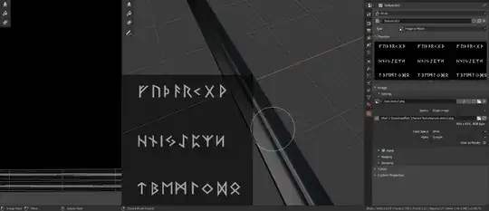

I'm working in the new 2.8 with someone else's file (made in a previous version of Blender), and I can't get the textures showing in the viewport. I've relinked all of them to the correct location on my computer and Blender can seem to find them, but just won't display them in the viewport. I've made sure I'm in LookDev mode, and also added a lamp, but still nothing. enter image description here In 2.79, it was always just a matter of finding missing files and that's it... Can anyone see what I'm doing wrong here?

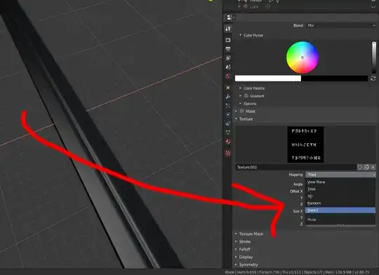

The texture might be tiled.
To change:
1. Go to PROPERTIES PANEL --> "Active Tool & Workspace Settings" (the screwdriver & wrench) Blender 2.8 Active Tool & Workspace Settings
2. Find the TEXTURE TAB --> Change MAPPING from "TILED" to "STENCIL"
Change Mapping from Tiled to Stencil in Blender 2.8

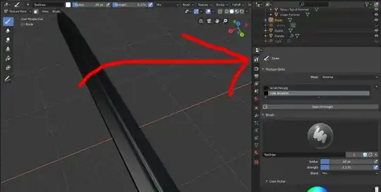

After this change, my texture was visible in viewport: Texture Showing In Viewport, Blender 2.8
I ran into a similar problem doing a Blender 2.8 sword tutorial on youtube. Answer credit goes to the comment section of that tutorial: Answer to this page's question
