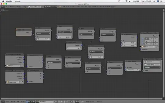

Perhaps you could use animation nodes?
animation
node set up
Here I have a blender sphere activating the light of another sphere when it gets close enough. Don't be intimidated by all the math nodes! It is just to get the timing right. The reason I subtract by 0.49 is because the radius of the sphere is 0.50. So, when the two spheres are near enough (within 0.10 blender units) of each other, then the emission will go to 1. If not, then the value is too small and the rounding functions keeps emission at 0. The "value" is the inverse of the proximity/distance between the spheres.
This is the blender file.
Do you want the light to stay on once touched? Perhaps have a 10 second delay and if it's not touched again, to turn off?
Let me know more details and I can make a better set up.

  • Thanks a lot my friend, wasn't expecting an answer that quick. I'll work it through and let you guys know about the progress. – Niklas Nov 21 '18 at 07:52
