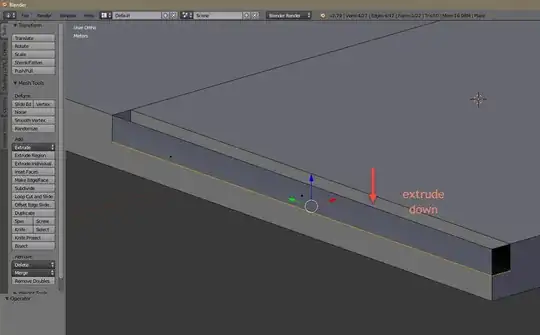

In Blender, I'm trying to do the same thing but it isn't working in the same way. I used the Knife tool to draw the area I want to remove and extrude down, but the outer edges are still remaining:
Blender: draw shape with Knife tool Blender: extrude down
I haven't yet figured out a way to manipulate the mesh to get the desired result after this extrusion.

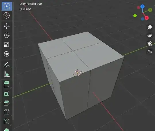

This feature has just been added to Blender.
It will be available from version 2.90(https://builder.blender.org/download/).
It's called "Extrude Manifold" and is located in the toolbox T, under the "Extrude" dropdown, Or by pressing Alt+E.
↑ Here I'm using Face select mode (3) but it works in vertex select too

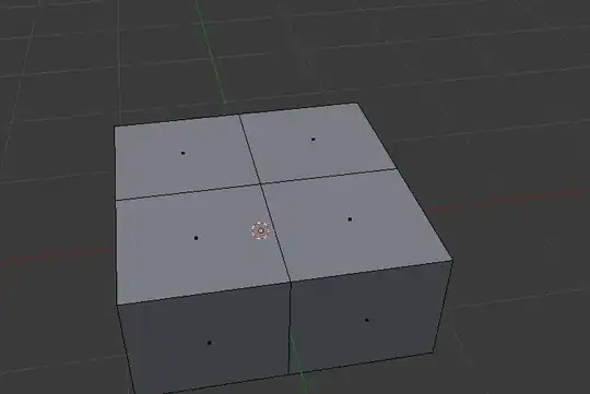

Unfortunately this feature is lacking in blender. You've got two options here - move all the faces down and only extrude the ones you want higher upwards. This would work fine in your case.
Before the extrusion
Afterwards
Alternatively you can delete the faces you don't want - this option is for when it doesn't work out with the first method.
