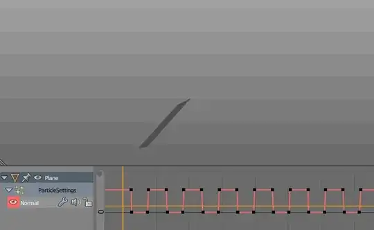

I have a plane acting as a simple emitter. It emits 10 particles from frame 1 to 4. And again from frame 11-14. And again from 21-24. Then there's a pause for 40 frames, and the entire sequence repeats, including the pause.
I need to find an automated way to cycle this emitter sequence. Ideally, the sequence could be repeated indefinitely using an F-Curve Cycles modifier.

Yeah in the link you provided there was a good answer.
I made a clear answer out of it: Just animate the Velocity of the particles.
You can automate the curve with F-Curve Cycles modifier (Shift+E):
If it annoys you that the 0-velocity particles keep popping up, you can model a structure around the emitter:
