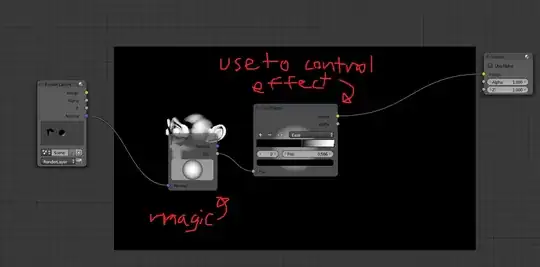

This works like a dream. ridiculously simple too. the normal node can be found under vector in the add node menu(shift-a). Magic Nodes

  • This won't work if the camera is at a different angle. The tricky thing with this is getting the normal of the camera (easy in material nodes, but I don't know of a way to do this in composite nodes without using drivers). Drivers should work, but the only way I've thought of involves converting the rotation of the camera (in radians) to a vector where everything stays inside -1 to 1. Then using that to drive the ball widget (since there are no vector math nodes in compositing). – gandalf3 May 30 '14 at 06:37
  • Yeah, I tried this. It mostly works, but the normals aren't based off of the camera. Rather, they are based off of how much they're pointing towards the corresponding pixels on the rendered image. – Zauberin Stardreamer May 30 '14 at 19:05
