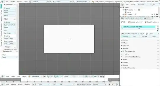

First, add the original movie/animation/image as a plane. In the plane's material settings set the shading to shadeless. Add a camera to the center of the world and clear its rotation. Move the camera up 5 Blender units. Align the plane in camera view so that it lines up with the camera borders. Add another plane 1 Blender unit above the plane that you are trying to distort. Scale it on the X and Y axis until it also fits the camera bounds (it's okay if it goes over a little bit.)
Visuals: Adding the subject.

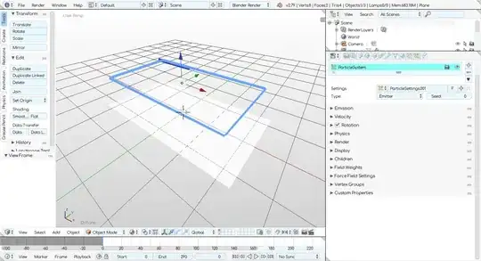

Setting up the view.
Adding the particle system.

Next, go back to the layer with the camera and the video/image that you are trying to glitch. Select the second plane that is above the object that you are glitching and in the properties panel, go to the particle system tab. Create a new particle system. Set the start and end times to the length of the footage and do the same to the length of the animation. Depending on the length of the animation you will have to adjust the emission number value. Set the lifetime to 1 and the random value to .5. Under "physics" set it to "no." Under "render" set it to group and select your group that has the glitch particles. Move the animation 1 frame forward to see the objects. Set the size to a resonable value where the "glitchy" objects are covering a large portion of the image. Uncheck emitter. Check rotation and change the initial oriantation to something that makes your objects appear in the right orientation. For me it was object Y or even global Y. If there aren't enough particles covering your subject matter consider turning the emission number up some.
Visuals: Setting up the particle system.
