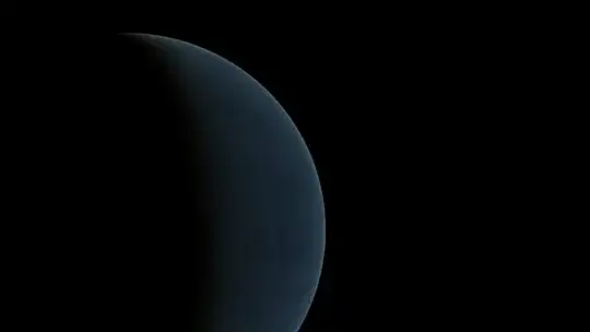

Below is an uncomposited version of my Earth render. You can see the light haze around the edges. That's the atmospheric scatter sphere that's a little bigger than the Earth itself. Once the light passes through it, it affects the surface of the Earth resulting in this nice orange color around the edges of the day/night transition. The problem, however, is the white haze around the edges of the planet itself are sharp and in order to affect the surface color, the atmosphere scatter sphere must be on the same layer, therefore, I'm unable to blur it slightly. earth render
This is the atmospheric scatter layer on it's own. I've tried duplicating it, moving the dupe onto a new layer behind the Earth and then blurring that to help hide the sharp edges but it's still not ideal, especially when up close. earth's atmosphere
Here's the finished composite. You may say "It looks fine". True, but this is at a distance and my project requires a gradual descend close to the planet. earth render and atmosphere combined
My question is, can I still have the atmosphere scatter mesh affect the surface whilst not being a part of the render itself? Can it affect the light off camera, so to speak?

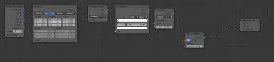

VOLUME SCATTER NODE SETUP: volume nodes
SOLUTION:
This is the best I could do with risingfall's answer. In order to get the light to change the surface I can't fade it as much as I'd like so from a far you can't really see the fade as much but it's miles better than before, I believe. full volume cycles nodes

Sorry if I'm not picking up on your situation exactly, but is your atmosphere scatter mesh using a volumetric shaded material? Is it only shaded by volume, or is there also a surface component?
If it is helpful, and if your volume scatter mesh is volume only, I can tell you how to add a gradient to the volume density. That means you can make the edges of the volume scatter effect fade out, rather than be abrupt.
Here is a two-sphere setup where the volume scatter sphere does not have the gradient:
Here is the same with the gradient enabled:
Hope this helps!
risingfall
  • 3,149
  • This certainly helps with the edge sharp issue, the problem now however is that, because the color ramp in plugged into the Density input, the Earth surface and clouds no longer have an orange hue as the density is no longer as high as necessary. – Stewie Feb 13 '18 at 03:30
  • One way to handle that, perhaps: stick a "Multiply" node in between the color ramp and the density input. See if multiplying by, I dunno, 5, 10, 20, 100 give you the results you want. By the way, as you probably noticed @R.M's response is very similar to mine, he just used a mathier (and more precise) approach to specifying the density gradient. – risingfall Feb 13 '18 at 03:45
  • Yep, trying it out now. Will update once I've got a good result. – Stewie Feb 13 '18 at 03:58
  • Sweet, I managed to get a good look using your method. I added a multiply between the color ramp and the volume scatter to deal with density. I did have to size up the atmosphere mesh slightly to get the orange to appear but It seems to nicely blend in now. – Stewie Feb 13 '18 at 18:35
