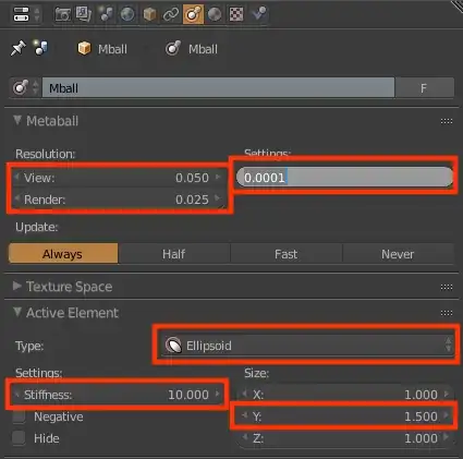

Metaball settings:
In Edit Mode set Resolution as low as possible, it will be better looking while rendering, as preview resolution is always a bit lower.
Really low Threshold along with high Stiffness will give more defined Mballs. As well as scaling Ellipsoid on Y axis. Higher scaling, more noticeable bumps.
mball
Particle System settings:
Nothing fancy here.
Tweak all settings as you like. In this example I've used ones below.
