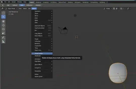

In Blender 2.8, Shade Smooth is in Object Mode(Layout Active Workspace), Object > Shade Smooth.(See picture below)

method 3 - Object menu
on the top left of the 3D view port, there is a small toolbar. One of the items on this toolbar is "Object", next to "Add", "Select", and "View". there is an option to select smooth or flat shading in this menu.
