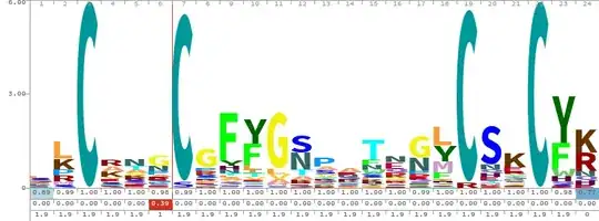

If you don't know, you could try looking for recognizable protein domains in your query protein (use PFam) and then use the HMM (hidden markov model) of the domain to identify important residues. For example, this is the HMM logo for the zf-A20 zinc finger domain:
zinc finger sequence logo
The huge cysteine (C) residues are shown that size because they are very conserved across proteins carrying this domain and, presumably, are functionally important for the domain. So, if you pass your protein through PFam and identify domains, find the important residues and make sure all your homologs have those conserved. If using PSI-blast, only include sequences where those residues are conserved in the results you keep.
