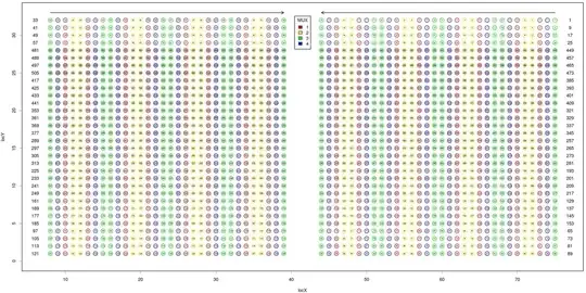

There are actually 2048 usable sequencing wells, hexagonally packed with four wells connected to the same sequencing sensor/channel via a multiplex (mux) selector. The combination of the mux and the channel number determines the physical location of the well. Unfortunately, the association between channel number and physical location is not obvious, and within each channel the muxes are also not in an obvious order, i.e. [3,4,1,2,2,1,4,3] for two adjacent channels.
Here's an "official" text description of the layout as it was for R7; it hasn't changed for the most recent flow cells (R9.5):
  • Channels 1-64 occur at the top of the chip (the other low channel numbers are at the bottom)
  • Channels order down the chip: 1-64, 449-512, 385-448, 321-384, 257-320, 193-256, 129-192, 65-128
  • Muxes run from left to right in the order: 3, 4, 1, 2, 2, 1, 4, 3
To confirm this layout, I pulled the channel/position lookup table definitions out of MinKNOW, and it seems to be the same as this:
Current MinION channel layout
Here's the code to produce this image (I haven't adjusted it to have a hexagonal structure):
#!/usr/bin/Rscript
library(rjson);
layout.fname <- "/opt/ONT/MinKNOW/Client/resources/app/resources/channels.json";
data.list <- fromJSON(file=layout.fname);
png("MinION_FC_Layout.png", width=3072, height=1536, pointsize=24);
par(mar=c(4,4,0.5,0.5), lwd=3);
data.mat <- matrix(unlist(data.list), ncol=2, byrow=TRUE);
plot(data.mat, pch=21,
     bg=(colorRampPalette(c("white","grey"))(2048))[1:2048],
     col=c("red","yellow","green","blue"),
     xlab="locX", ylab="locY", cex=2,
     xlim=c(7,76), ylim=c(0,33));
text(x=data.mat, labels=rep(1:512, each=4), cex=0.4);
legend("top",legend=c(1,2,3,4), fill=c("red","yellow","green","blue"),
       inset=0.05, title="MUX");
text(x=6, y=data.mat[data.mat[,1] == 8,2],
     labels = ceiling(which(data.mat[,1] == 8) / 4));
text(x=77, y=data.mat[data.mat[,1] == 75,2],
     labels = ceiling(which(data.mat[,1] == 75) / 4));
arrows(x0=c(8,75), x1=c(39,44), y0=33, length=0.2);
invisible(dev.off());

  • an interesting thing to note is that this answer is different from @wouter-de-coster answer that comes from poRe. As far as I can tell, this is the correct answer. – roblanf Jun 16 '17 at 05:57
  • I think the layout in poRe was based on the numbering in the original MinKNOW GUI (which was also incorrect). – gringer Jun 16 '17 at 07:19
  • for those interested I built an annoying by-hand implementation of the mapping to use for plotting in R here: https://gist.github.com/roblanf/df47b9748c3aae00809cc675aca79989 – roblanf Jun 16 '17 at 13:06
