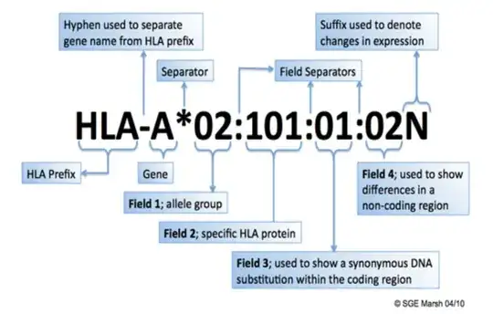

Example of explanation of other allele pattern from here
This explanation of the patterns doesn't explain the part of the pattern in UniProt like (A-11E).
