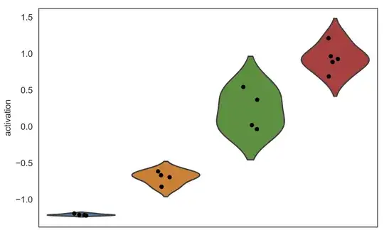

As a control, I plotted the activation score (computed with scanpy) based on the 24-gene signature applied to the bulk samples from which it has been extracted. As you can see, the score always increases from the first timepoint (blue) to the last (red).
activation

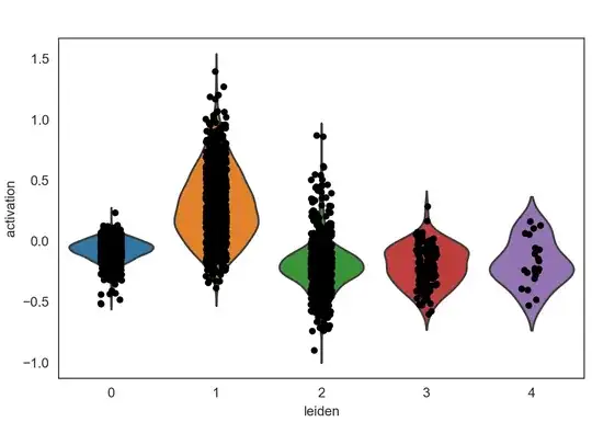

However, when I use the same scoring procedure on a single-cell RNASeq sample containing the same populations, I think something may be wrong.
In the following the violin plot of the extracted activation score on an unsupervised clustering on single-cell data. Excluding cluster 4, which we identified as contamination, while cluster 1 and cluster 0 are supposed to have the correct degree of activation, clusters 2 and 3 have a lower degree of activation with respect to cluster 0 (which we identified as the first timepoint - lowest activation on bulk).
activation-sc
What may be the causes of this behavior? Right now the possible explanation I came out with is that:
Are there other possible explanations for this behavior, and how to check for them?

  • How do you know the temporal relationships between clusters in the single-cell data? – TimStuart Mar 05 '19 at 20:00
  • @TimStuart, I correlated the expression profile of each cell in each cluster with the expression profile from independent single-cell samples in which I know the temporal relationship. Cluster 0 is more correlated to the first timepoint, while cluster 1-3 are more correlated to the consecutive timepoints. – gc5 Mar 05 '19 at 20:12
  • You assume that your gene signature is originating from a single cell type, from the "activated cells". This so called activation can result from an interplay between different cell types (this is just a speculation as I do not know your experimental settings and the biology here). A heatmap of genes vs clusters would show the "source" of the signal. In my field (cancer), we have observed that tightly related coexpressed gene modules (bulk RNA-seq) might originate from diverse cell types (scRNA-seq). – haci May 08 '19 at 07:29
One explanation could be that your mapping of clusters to timepoints is not accurate. There are other methods you could look at for doing this, for example scMap, scPred, or Seurat v3 (disclosure: I am one of the Seurat developers).
Another possibility is that there is some problem in the calculation of the activation signature. You could instead look at the expression of the 24 genes themselves in each cluster (for example by drawing a heatmap).
The difference between bulk and single-cell here could also be biological. This could happen if the increase in expression of those genes in bulk was due to a change in cell type frequency over time rather than increased expression.
