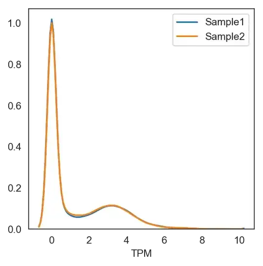

The distribution of the two samples using the common set of genes looks similar:
TPM distribution
However, the two samples have only been tpm-normalized, is it enough to guarantee reliable fold-change estimation? Should I use another normalization procedure, e.g. Quantile Normalization, before comparison?

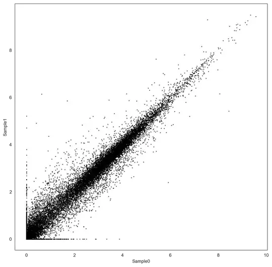

My objective is to define a signature using the genes that are up-regulated in Sample1 with respect to Sample0, and vice versa. I'm using log fold-changes, but I'm concerned that their value may be affected by each sample distribution.
Do you also have suggestions for the definition of up-regulated genes with these data?
scatter
