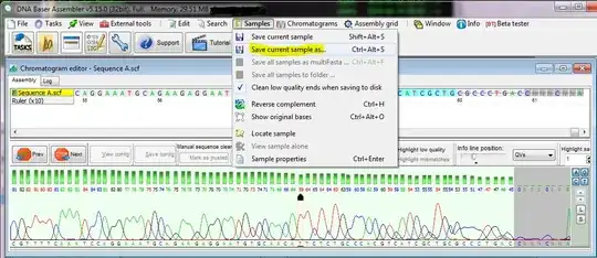

DNA Baser Assembler will convert ABI to SCF (and other formats). Just double click the ABI file you want to convert then go to the "Samples" menu and choose "Save current samples as...". Plus, it can automatically trim the low quality ends.
enter image description here There is another tool in that package what will convert all ABI files at batch: Chromatogram Explorer. There is a Lite version that is free, but the conversion to SCF might only work for the first 100 files (if I remember correctly).
Related to the comment posted by BioGeek about the Genious license: DNA Baser Assembler does not require a license key. It will work right away.
