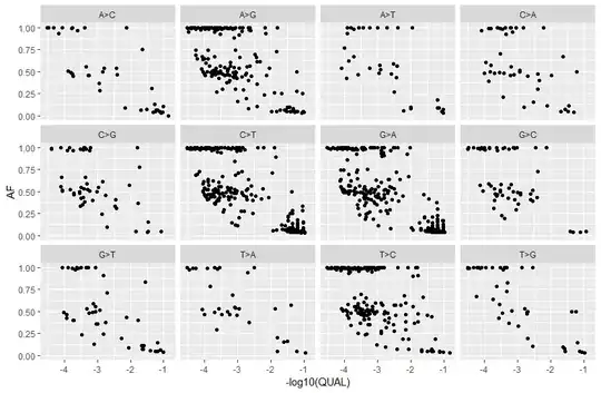

Having inspected one of my samples (with estimated deamination metric, the proportion of called SNPs consisting of C>T or G>A transitions, of 0.837), this looks like a straightforward filtering procedure. Looking at the minor allele fraction (AF) and the quality score (-10 log10(p-value)) per type of SNP:AF v QUAL per SNP type it can be seen that the C>T and G>A transitions likely caused by deamination (and PCRing up the deaminated DNA to get the libraries) all cluster in the bottom right of the plot - low AF and low QUAL, so setting thresholds to the left (higher QUAL) and above (higher AF) the groups will remove these from the called variants.
