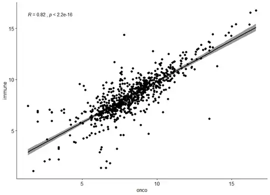

I have the same patients and genes in two separate matrices coming from two sequencing panels with the same chemistry. Each sample has a match in another panel. I want to remove genes that have low correlation between two matched samples.
I have normalised and log-transformed the data by DESeq2.
I just plotted the correlation between each pairs of samples:
library("ggpubr")
ggscatter(my_data, x = "sample1", y = "sample1_1",
          add = "reg.line", conf.int = TRUE,
          cor.coef = TRUE, cor.method = "pearson",
          xlab = "onco", ylab = "biomarker)")
Like this:
by:
corr_test(a, b, 0.95)
I can calculate correlation, but I don't know how to remove genes with low or non-significant correlation between matched samples.

Nice data and good question.
It is called "outlier" analysis or the analysis of the residual. Its an easy analysis, but . You calculated the standard deviation using the regression slope as the 'mean' and retain data within 1.96 standard deviations. You can plot the data like this and if you are lucky will see the residual forming a nice 'normal distribution'. Outliers outside 1.96 sd can be formally excluded.
Calling (and plotting) the residual from the regression slope will be possible in R, but I use external packages because its easy. BTW you should also try Spearman's coefficient to check you are getting the same answer.

    Thanks a lot actually I need my data cleaned from genes with low correlation because I want to combine my data sets. I was not able to find a line of code to remove such genes although I can plot them in correlation plot. – Zizogolu Jan 16 '19 at 08:18
  • The specific statistic is "standardisation", its easy to calculation, but really its just working out the SD. Any could good stats package will calculate residual, I like "DataGraph" (Mac). – M__ Jan 17 '19 at 12:48
