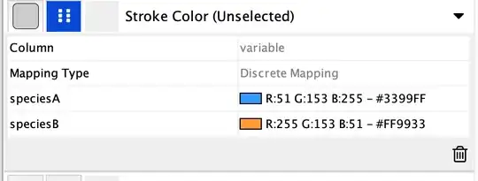

An easy way to visualize this is to make a tab-delimited table that contains edge information for both species and both networks, color the edges depending on the species, and make the thickness and transparency dependent on the interaction strength.
For example, say you have a list of orthologs for the two species and just assign them a number or a name. Each edge has a "source" and a "target". The edge weight is the interaction strength.
(Note do not copy-paste the below table as the mixed tabs/spaces may make the graph topology incorrect). In my toy dataset the data look like this:
source  target  variable    value
gene1   gene2   speciesA    3
gene1   gene3   speciesA    42
gene2   gene3   speciesA    3
gene1   gene2   speciesB    9
gene2   gene3   speciesB    5
gene2   gene4   speciesB    41
gene3   gene4   speciesB    32

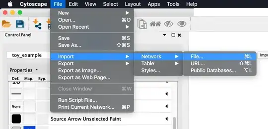

Import your network to cytoscape as a network from a file:

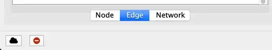

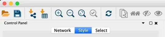

Then go to the style tab:
... and make sure edge is selected.

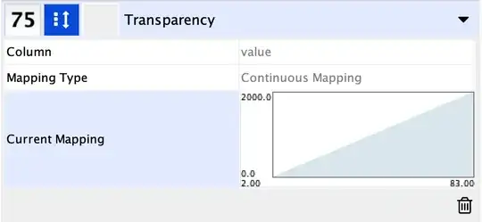

Then you can adjust the transparency, edge color, and edge stroke settings, like so using edge stroke color:
enter image description here:
... and transparency panels as examples.
Don't forget to save your style when it is complete!

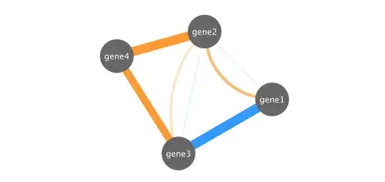

When you have adjusted these settings you will have something that looks like this:
