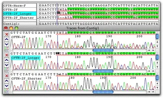

In other words, something like the top track in the open window in this image.
Indel Chromatogram (Source: CodonCode.)

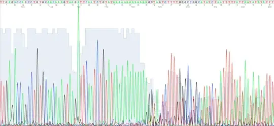

With my own chromatograms, I have a lot of doubt about distinguishing noise from indel. Here's an example, visualized with 4Peaks. (Full chromatogram here.)
On the left, the chromatogram appears high quality. There are sharp, regularly spaced, single peaks. On the right, there appear to be two sets of peaks lined up with each other. Does this constitute evidence for an indel? Does the homopolymer region—I've noticed in many of these samples, the putative indel seems to start in a homopolymer region—cast doubt on this?
I've also noticed that in some situations like this, there appear to be not two but three peaks.
Is one of these just noise and can be disregarded? Or does this cast doubt on the validity of the data—which is supposed to be coming from the diploid human genome?

Your two points are correct. Basically, at some position, you start to see two streaks of overlapping peaks. Once identified, the two streaks can be aligned to each other if you shift one of them. This is a strong constraint, but it is hard to tell by eye because it is not obvious how to assign peaks to streaks without running an automatic tool. Doing this is even more difficult given noisy traces like your last figure. I think you'd better run polyphred or similar.

The INDEL mutation rate in long homopolymer runs is orders of magnitude higher than elsewhere in the genome. This has two implications: 1) you expect to see more homopolymer indels; 2) PCR polymerase is more likely to introduce errors in homopolymers––a higher fraction of homopolymer indels tend to be wrong.

Concerning your second chromatogram: This is not an indel. As the other already said, this is a mistake made by the polymerase. Invitro polymerases doesn't like homopolymer stretches. They begin to add extra bases or "forget" one. As we do PCR this error accumulates. In my experience up to 9 time the same base is not a big problem, 10 only if you have luck, from 11 upwards your sequence are terrible. If you are interested in the sequence part behind this stretch, you have to sequence from the other direction.

  • You see no significant drop-off of the average peak height and the additional base peaks are to small. That's why it's unlikely that there is a heterozygous indel. But as I wrote, the homopolymer stretch is to long to be sure. I wouldn't give any definitively answer here. – finswimmer Dec 17 '18 at 06:33

Sanger sequencing produces a bit of messy signal at the start and a lot at the end of the sequence, but should have a region of clean signal in the middle. If the signal is getting mixed up in the middle, it suggests that there are sequences that are out of phase with each other. That could be a heterozygous INDEL, but it could also indicate that multiple template sequences have been amplified by the same primer.
Sanger sequencing is frequently carried out in both directions (forward and reverse complement), and if similar things are happening in both directions at the same place, it makes it more likely that there is a heterozygous INDEL and not something else funny going on. It's a very good idea to have homozygous templates for all expected variants, if possible. If the secondary peaks in the signal match what is observed in the homozygous variants, that can also be used as evidence. In the absence of control sequences, it is also possible to eyeball the peaks to find self-similarity.
Where triple peaks are seen, that could point to a region where there are two INDEL variants in close proximity, or multiple regions getting amplified at the same time, or even a single INDEL variant with more than two variant states (e.g. a homopolymer with 8 As that is sometimes 7 As, and sometimes 9 As).
