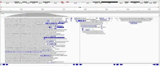

I have some sequencing data from a captured region that is a known paralog edited. For now, I have been mapping the data using standard minimap2 flags for PacBio DNA sequencing:
minimap2 -ax map-pb GRCh37.fa fastqfile.fastq > samfile.sam
I captured a 10kb region and what I am seeing in IGV is puzzling. The region directly before and directly after the paralogues are covered at about 1000X, but the genes themselves are not covered at all:
The two genes in the middle are the paralogues. I left them off to protect data. This data is also only the sorted data, the duplicate marked data has lower coverage (600X).

The interesting thing is, while my average read length was 6kb, I am seeing the reads here are about 4kb. I have another region with very high coverage where the reads spanned both paralogues and mapping was successful.
Question: Why am I only seeing reads that are about 4kb long when the average read length for this dataset is 6kb?

    Given that there are no spanning reads, I think that your igv screenshot is more likely to be caused by non-specific capture than by alignment. If it were me, I would double check capture probes. – user172818 Dec 12 '18 at 01:11

As to why none of the reads mapped to the paralogs: Perhaps they have low mappability, as in they are repetitive? Also, maybe the capture didn't work properly? It looks like there is serious sequencing bias to the dataset given the uneven coverage.

Are the reads that are mapping actually 4kb, or are the alignments only 4kb long? You may have many 6kb-long sequences that have been clipped at either the 5' or 3' end. If this is not a heavily-curated genome then the assembly may be incorrect around the paralogs, preventing proper mapping.
One suggestion is to take whole-genome long reads from the same organism and to map them. Then check if the mapping to this region is equally strange compared to your capture data. This will give you a better idea of what caused the uneven coverage and seeming lack of coverage around the paralogs.
