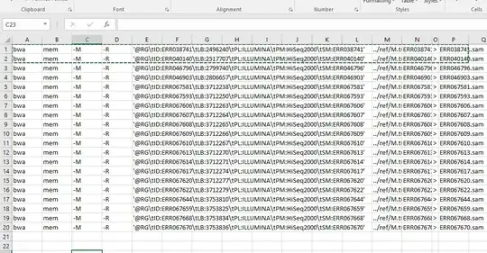

Hi im doing Variant calling on fastq files for which i have 4000 fq files and the variant calling are done in different 9 steps. Each step generate different files that are output to next steps.
So can anybody help me with this to do it in a loop it pick up names from previous steps for all files. Step 1 command is here:
bwa mem -M -R '@RG\tID:ERR040140\tLB:2517707\tPL:ILLUMINA\tPM:HiSeq2000\tSM:ERR040140' ../ref/M._tuberculosis_H37Rv_2015-11-13.fasta ERR040140_* > ERR040140.sam
So i made an excel file to break the command in columns so that i can change the file names keeping remaining command same just like this:
command_column_wise
So changes are occurring 5th, 7th and 9th column. which are:
tID:ERR040140
tLB:2517707
tSM:ERR040140
ERR040140_*
ERR040140.sam
Can anyone help me with loop or something?
Thank you!
Safina A.R
  • 119
  • Please [edit] your question and replace the image of the excel file with a copy/paste of the same file exported to tsv (save as 'tab separated text file'). That way we can actually copy it and use it to test our examples. – terdon Dec 11 '18 at 11:13
  • Please remember to confirm an answer once you've received one. – Stephopolis Dec 11 '18 at 18:38
    I have already given the excel file command above. And im unable to paste it here the page is not letting me paste it that is why i quoted 1 example and than added a picture with all other repeating commands with different file names. – Safina A.R Dec 12 '18 at 04:23
