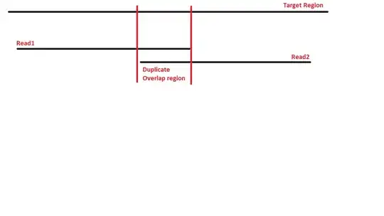

I then found out that samtools depth double counts these overlapped regions even though they are technically from the same molecule in sequencing and would be a duplicate bases in the read. See the image for an example:
Duplicate Region
Each base in this Duplicate Overlap region is double counted when it shouldn't be. How do you guys deal with this duplicate overlap region when calculating coverage across a bam file?
