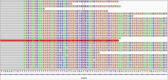

Skipping some specific background, what I want to do is judging whether some soft-clipping sequences are the same, which may result by the same SV event. Colored bases in Fig.1 is an example of soft-clipping sequences.
Fig.1 an example of soft-clipping sequences

  1. Extract these soft-clipping sequences
  2. Choose the longest one as the reference
  3. Iterate others to match with the reference, if the number of unmatched is large than 1, it means these sequences are not the same.

You just need to check the flag for suplementary mapping. If there is suplementary mapping then use the coordinates; if they are all the same the seq is the same and you just have one event, if different reads have different suplementary mapping locations then there's multiple events. The problem is more complex than this though so just use an existing tool.
