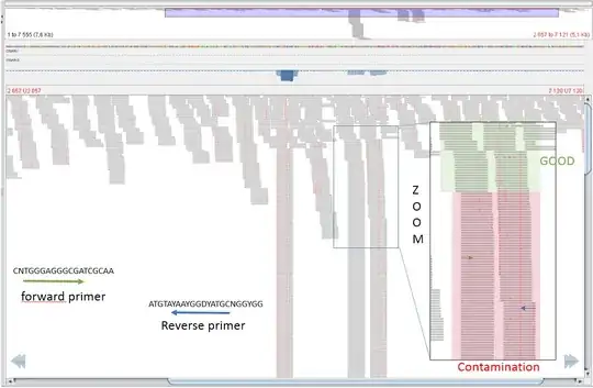

Here you can see a tablet visualization illustrating the contamination (2 contaminations). I obtained that image with a mapping on a known reference of my virus. twin towers and world trade center

The problem I have is that these PCR products are exactly the type of sequence I want from my extract (identifying part of the virus). So I have some "false positive" and some misidentification of viruses present in the extract.
I have thought about removing all reads containing primer sequences but it leads to a gap in my data and I can't identify the viruses in my extract anymore. I am thinking that all of the read pairs that begin before or end after my primers are "true-positives" and I would really like to keep them (even having the primer sequence in them).
Do you know any tool that can help me in that situation? i.e. removing reads containing a sequence but only if it begins with it.
If the tool can also handle the degeneration of my primer it would be perfect.

  • @DevonRyan I added some graph to explain my problem, I hope this is clearer now. I didn't try anything yet but I will try a cut-adapt method today and the bioawk method proposed by conchoecia. – Untitpoi Oct 11 '18 at 07:49
