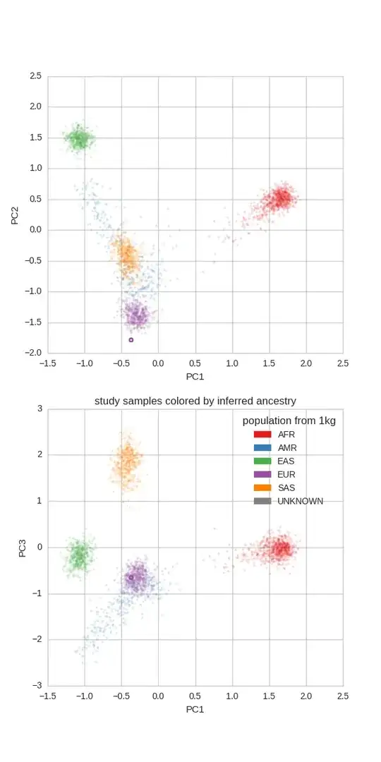

peddy is a Python package that samples an input .vcf at ~25000 sites and projects onto a principal component space built on 2504 thousand genome samples. The author has extensive documentation of the tool's features and a link to the preprint.
I downloaded the .vcf and .vcf.tbi for the NA12878 sample from Genome in a Bottle's ftp here. Then, created a custom .ped file, NA12878.ped, with the contents:
NA12878 HG001 0 0 2 0
At the command line:
$ peddy --plot --prefix myvcf HG001_GRCh37_GIAB_highconf_CG-IllFB-IllGATKHC-Ion-10X-SOLID_CHROM1-X_v.3.3.2_highconf_PGandRTGphasetransfer.vcf.gz NA12878.ped
The output files all have the prefix myvcf., here's myvcf.pca_check.png myvcf.pca_check.png
Kevin
  • 366
  • I think it might be worth adding: peddy requires coloredlogs and cyvcf2 the later of which will required you to have gcc&g++ and the headers (e.g. -dev versions in ubuntu) of libbz2, liblzma and curl. This knowledge would have saved a precious 15 precious moments of my life :) – George Feb 09 '20 at 00:32
  • Also, now that it's installed I seem to get the error: AssertionError: error loading tabix index for b'HG001_GRCh37_GIAB_highconf_CG-IllFB-IllGATKHC-Ion-10X-SOLID_CHROM1-X_v.3.3.2_highconf_PGandRTGphasetransfer.vcf.gz' (Also based on my understanding shouldn't the 2 be 0 or left to the user to set based on his gender ?) – George Feb 09 '20 at 00:41

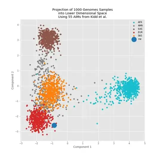

Adding another answer that, while much more involved, offers flexibility, walks through minimal steps, and provides visualizations.
I created a Dash app and repository that explores this type of analysis using published ancestry informative SNPs and 1000 Genomes Project Data.
  1. Identify published ancestry informative SNPs (AISNPs).
  2. Download 1000 Genomes Project genotype bcf data.
  3. Limit genotype data from (2) to AISNPs loci from (1).
  4. One-hot encode the genotypes.
  5. Perform dimensionality reduction (PCA, t-SNE, or UMAP)
  6. Plot components.
The original post seemed to want to project their genome against a reference sample. The plot_walkthrough.ipynb in the tgviz repo shows how this can be achieved.
Output from the notebook on my own data:
Kevin
  • 366
