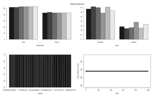

However it is specific for Illumina and for a limited number of plates: "plates that hold 2, 4, 8 IlluminaBeadChip chips and have 24, 48, 96 wells, respectively."
It doesn't take in consideration the numeric values:
library(OSAT)
inPath <- system.file('extdata', package='OSAT')
pheno <- read.table(file.path(inPath, 'samples.txt'),
                    header=TRUE, sep="\t", colClasses="factor")
pheno$AgeGrp <- runif(576, 0, 100)
gs <- setup.sample(pheno, optimal=c("SampleType", "Race", "AgeGrp"))
gc <- setup.container(IlluminaBeadChip96Plate, 6, batch='plates')
gSetup <- create.optimized.setup(sample=gs, container=gc, nSim=1000)
It handles both numeric and categorical data, but it can only optimize for two nominal criteria.
It can handle both numeric and categorical data for an arbitrary number of variables. It is not restricted to an even number of samples per batch.
