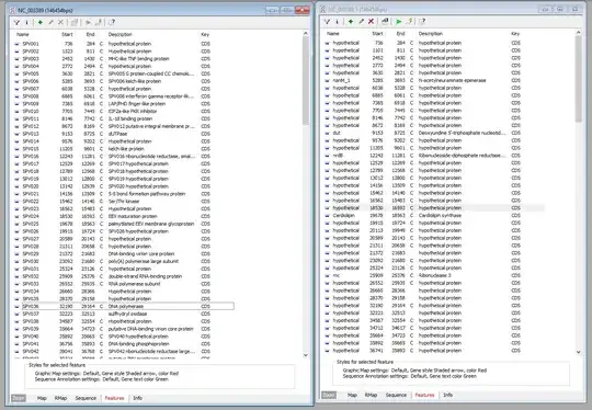

I have attached the image for comparison. Left one the Swinepox genome in .gb format and right one is the same genome annotated with Prokka.
Image : sorry for the low quality screenshot

Both of the annotation tools you used are designed for prokaryotic genome annotation. I would not expect them to work very well for viruses.
heathobrien
  • 1,816
  • You can choose between Bacteria, Archea or Viruses when using prokka. So, I think it should work for viruses too. – L R Joshi Jul 21 '18 at 19:33
    @LRJoshi viruses (especially small ones) tend to have overlapping and nested ORFs: something a standard prokaryotic/eukaryotic gene detector (e.g. Glimmer, Genemark, Prodigal) is unlikely to account for. – Eli Korvigo Jul 21 '18 at 19:47
  • Prokka can do viruses, but you may want to change which translation table it uses to get better blast results – Joe Healey Dec 24 '18 at 10:47
I was able to get good annotation using prokka by using following commands in prokka.
prokka --proteins reference.gb --outdir annotation  --prefix myprotein contigs.fa
All the reading frames were annotated. Actually the ones that are hypothetical in reference genomes are also annotated.
