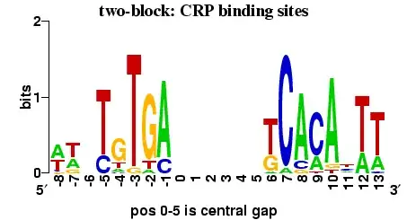

CRP binding site logo
(This was taken from here and you might want to read through it.)

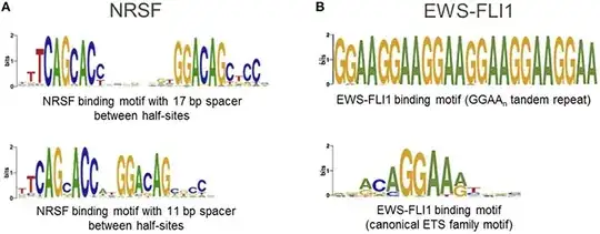

enter image description here (source: Front. Genet., 23 February 2016 | https://doi.org/10.3389/fgene.2016.00024)
The main take home messages from these images are:
  1. Different positions have different importance and potential to disrupt binding. In the first image, I would expect that changing the T at position -3 to anything else would be pretty bad. However, changing an A to a T at -8 would likely be neutral.
  2. Different TFs have very different binding sites and very different binding site lengths. Look at panel B of the second image. That one appears to be a very conservative site and likely any change would be deleterious. Conversely, changing any of the nucleotides of the 17bp spacer shown in panel A would likely not be important as long as you don't change the length.
Please note that I have not done more than glance at the sources I took these from, so my inferences may well be wrong, I only use them to illustrate the general point: you cannot really put a number to this. You will always need to look at each specific change and each specific position. In some cases, a single change can disrupt binding while in others multiple changes might have no effect at all.
