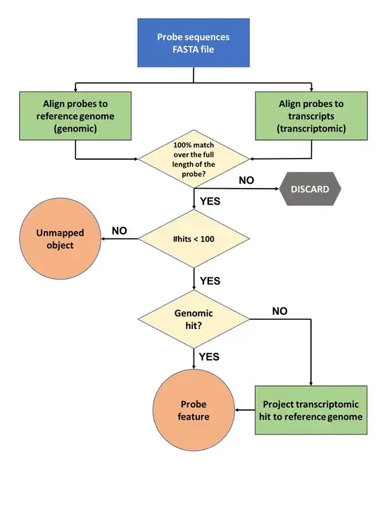

Your dataset was produced on a microarray. The probe IDs in the FASTA file are similar to read IDs produced from other NGS experiments like RNA-Seq. According to the workflow provided by Ensembl the first step is to align your reads to a reference. You'll only keep the reads that match the reference completely. Once the probes are aligned you'll be able to quantify the number of reads mapping to the gene that the probe was designed to attract.

  • This is demonstrably not the answer to the OPs question, the OP has not got a FASTA file of probe sequences, equally the hits < 100 step and "quantify the number of reads mapping to the gene" - would only be appropriate for a RNASeq experiment, in this case expression is via probe intensity measurements not read count, counting the number of probes would simply be a bad proxy for gene length. This is simply an ID mapping issue. – Matt Bashton Jul 24 '18 at 13:05
  • Mapping to Ensembl won't help either as it only has the Gossypium raimondii genome were as the Affy Cotton array is based on Gossypium hirsutum. – Matt Bashton Jul 24 '18 at 13:10
