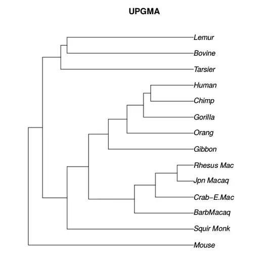

treeUPGMA <- upgma(dm)
plot(treeUPGMA, main="UPGMA")
dev.off()

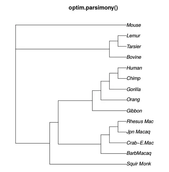

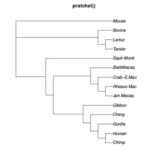

treePars <- optim.parsimony(treeUPGMA, primates)
treeRatchet <- pratchet(primates, trace = 0)
plot(treePars, main="optim.parsimony()")
plot(treeRatchet, main="pratchet()")
dev.off()

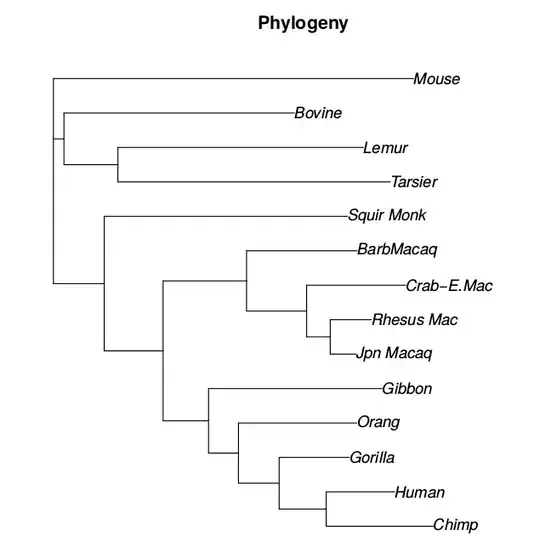

# Calculate branch lengths using the most parsimonious tree identified by
# the pratchet() searchh algorithm
phylogeny <- nnls.phylo(treeRatchet, dm)
plot(phylogeny, main="Phylogeny")
dev.off()
