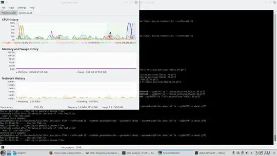

The size of the genome is 13.5 GB and the server capacity is 32 cores with 125 GB RAM, how this error can be resolved?
Memory usage: enter image description here
