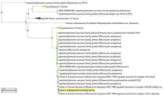

There you go, its Microcystis aeruginosa aspartate/glutamate racemase. Easy does it. If you want to know how you can do this in 15 seconds let me know.
Its one of the new features of NCBI's Blast
  1. Go to Blast here, https://blast.ncbi.nlm.nih.gov/Blast.cgi
  2. Enter your sequence into the box (it doesn't accept PDB codes alone)
  3. Enter the protein database - when I first did this calculation I used SwissProt, thinking there would be alot of sequences - I then used "nr"
  4. Under the algorithm parameters enter "50" (default is too many)
  5. Hit "Blast"
  6. Once the search is complete at the top of the page are the hyperlinks: "Other reports: Search Summary [Taxonomy reports] [Distance tree of results]"
  7. Click on "Distance tree of results"
  8. The following page will load automatically, automatically aligning your sequences and producing, in this case a parsimony based tree, but there is also the option of a nj tree (recommended) .... here: https://www.ncbi.nlm.nih.gov/blast/treeview/treeView.cgi?request=page&blastRID=5A1ZBRU1014&queryID=lcl|Query_210080&entrezLim=&ex=&exl=&exh=&ns=50&screenWidth=1280&screenHeight=800
  9. Click "Tool", "Download", "PDF" ...
